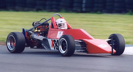

minitici
| posted on 28/6/07 at 05:32 PM |
Forgot to mention that my Atavar is a picture of my sprint/hillclimb race car which had a complete Mini subframe/engine/gearbox/suspension fitted to
the rear of an old FF1600 chassis!

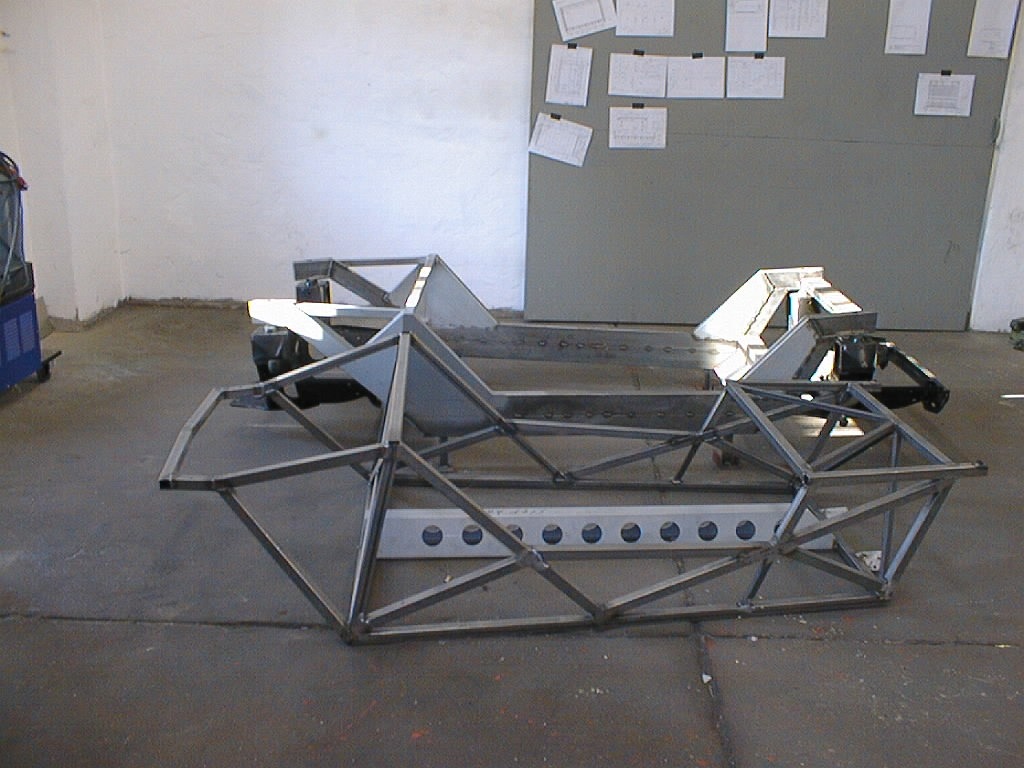

Surrey Dave
| posted on 28/6/07 at 06:20 PM |
Groovy Eh!!
Surrey Dave
| posted on 28/6/07 at 06:21 PM |
Love It!!
Great colour scheme too!!
[Edited on 28/6/07 by Surrey Dave]
Surrey Dave
| posted on 28/6/07 at 06:24 PM |
Eh!
