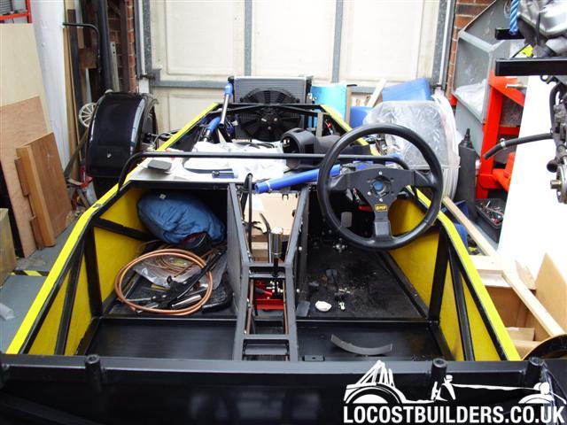

robinj66
| posted on 18/7/07 at 10:24 AM |
Here are a couple of pics of the set-up
The second one shows the idea but I would propose using thicker plate to be welded onto the side of the rear stay.
The query is really whether the angleof the harness (coming horizontal off a diagonal strut) would be detrimental or an SVA fail. Any comments?
[Edited on 18/7/07 by robinj66]
| posted on 18/7/07 at 11:55 AM |
If you have any of your tube left you could make a boss with a plate on the end and a nut welded to the back of it and mount it under your tube or on
the side.
