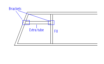

| posted on 30/9/07 at 10:52 PM |
If it will clear your coil over, you can fix the overhanging brackets problem with an extra bit of tube as shown below:
