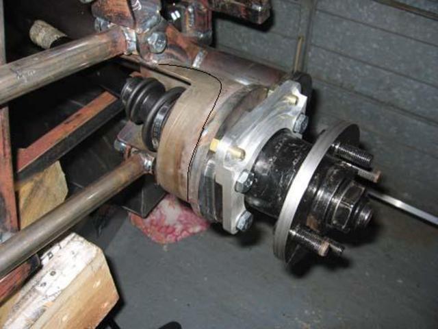

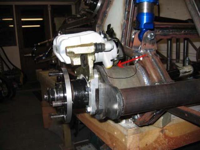

I've just fitted the rear drum to disk conversion from Rally design.... and this is the result..
  don't fit one
The arrow points to where the pipe attaches.... it's fouling the de-dion and it's not even straight (parallel to the disk)...
The holes on the hub carrier are asymmetric so you could only rotate the mounting through 180 degrees...
and the hole for the the brake hose is tight against the hub carrier so 90 degrees don't work (it comes with banjo fittings.
it would have to be a hole or come in through the bleed nipple and that means no bleeding of the brakes.. Help
I'm sure the pipe isn't going to attach and even if I cut a hole in the tube it's going to be tight (would that be safe?)
Anyone else had this problem?
Anyone got a work around?
Or do I have to send them back to Rally Design and get the pimping 4 pots (overkill!!)
This is the view with the caliper off
  dont fit 2
oh yeah... that's one of John Roberts de-dions
Any help appreciated...
A.
[Edited on 9/10/07 by bpgoa]

I'm not familiar with the conversion but can you rotate the caliper bracket 90 degrees and mount the caliper in front of the hub rather than on
top?
Raz
russbost
| posted on 9/10/07 at 10:34 PM |
Looking at how beefy that axle housing is I can't imagine that cutting a small hole would significantly affect it's strength. What exactly
is the problem with the pipe attachment & would a cranked end on the fllexy pipe help? I can do braided flexies with anything up to a 90degree
crank if that helps at all - see my archive for pics of sample hoses (none of the 90 deg cranked unfortunately).
[Edited on 9/10/07 by russbost]
Ketchup
| posted on 9/10/07 at 10:58 PM |
i recon that the plate needs moving 90 deg as raz said, so the caliper is leading instead of being on top, it looks odd fitted where it is

BenB
| posted on 10/10/07 at 09:10 AM |
That doesn't look right!!
How is the brake disc attached? I can't see how with the set-up the disc will sit in the groove in the caliper!!!! Unless I'm being dim
this morning that's more of a problem than the brake fluid pipe clashing with the uberhuge axle tube!!!

I think you really have to sit down for a sanity check here.
The facts are
The De dion looks over engineered in terms of thickness and sizes.
The calipers won't fit the de dion as it is.
Some of the options are
(1) Major surgery to the de dion -- it won't be elegant but it is so heavily over speced it won't cause stiffness or strength
problems.
(2) Fit drum brakes.
(3) Try different calipers
(4) Fit a different De Dion
(5) Fit a live axle ---- might actually be the best option.

| posted on 11/10/07 at 12:28 PM |
Remove metal here
[/I]
britishtrident
| posted on 11/10/07 at 12:30 PM |
Like this
[Edited on 11/10/07 by britishtrident]
[/I]
Syd Bridge
| posted on 11/10/07 at 01:24 PM |
I don't think I'd take out quite that much!!!
A small notch to accommodate a 90degree bend wouln't hurt though.
SYd.
[Edited on 11/10/07 by Syd Bridge]
ettore bugatti
| posted on 11/10/07 at 06:57 PM |
Didn't you punt the lefthand part (caliper bracket) on the right side and vice versa?
If you change them it looks to me that the caliper moves too the outside.
britishtrident
| posted on 11/10/07 at 07:02 PM |
SYd.
Most the material to be removed is carrying zero load, an FEM would run would show that.
Also the material thickness of assembly is so thick it gives a massive safety factor.
[/I]
britishtrident
| posted on 11/10/07 at 07:04 PM |
Well spotted that should help
[/I]
