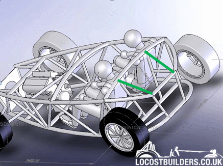

I have been lurking for a while and learning heaps of good stuff. My intention is to build a BEC project and as you see I have opted to make it
front-mid-engined as I think that the irritation of reverse is best solved with a Quaife reversing box and not a big mess of gears and electric motor
and other Heath Robinson stuff. Id be interested in your opinions of the initial design. Click on images for a larger size.
I'm planning to construct the chassis with a steel called Hi Lite made here in Australia. The larger tubes will be 50x2mm and the smaller
diameter will be 35x1.5mm.
Thanks to information off the forum I'll also be looking for a Freelander diff and driveshafts for the rear. All suspension will be pushrod
coilovers and unequal length 'A' arms.

Hi Nice concept - great name too! Looking at your frame sketch the area between the front suspension pickup looks a little open. Have you considered
how you will pass the loads into the chassis yet?
It is this front "box" that often seems to be the fist area to be strengthened when people set out to make Locost chassis stiffer. The
catering-van (another great name!) CSR introduced a load of stiffeingin this area.

Thanks for the feedback. Puk I'm going to use a laser cut sheetmetal part in the front of the chassis, less hassle than a load of small tubes.
I hear what you're saying with regards to the steel Doug. I'm not married to the idea of using the Hi Lite. Actually the whole idea
started off as a mid-rear but I thought if it's going to be a modern Lotus Seven style car it really should be mid-front. I wonder how many
production cars would pass 4Kn too. You just have to wonder at our bureaucracy here in Aus. What are they trying to achieve with these enthusiastic
targets? maybe it's just to discourage us.

Yeah, that's been bugging me I think I need another 100mm for the passenger compartment opening front to rear. This is the second draft of the
chassis and there will probably be others. The basics will stay pretty much the same though.

Anyway, the passenger opening is larger now and I've put in a draft of the bulkhead for the suspension in the front. An identical one would be
in the back. I had a look at the Caterham CS chassis and they've put a couple of pyramid structures in the front, very stiff! There is a bunch
more triangulation to go into my effort, and a transmission/propshaft tunnel. Comments are welcome

Your track is very wide. So big lateral G's is no problem
Mind the propshaft, though.
You will need in this config a split one. Since you not connecting @ the crank, but at the transmission.
Still you are at the right direction.
Keep the progress!
Benonymous
| posted on 19/12/07 at 10:32 PM |
Yeah, I figured on a split propshaft with the quaife reversing box acting as a centre bearing. If it ends up putting the reversing lever in a
difficult place I'll just remote it.

A little progress. I have dealt with a couple of issues. The main one was that the rear wheels lacked sufficient clearance from the vertical tube at
the rear and the curved top tube. I thought about it for ages and decided to extend the wheelbase 200mm to move the diff centre back. I also
ditched the curved tubes at the top and bottom rear and went with straight ones. Much simpler. I have also added a truss that goes in to tie the rear
suspension subframe to the top rear cross tube.
Comments and suggestions are welcome :-)

quote: Originally posted by Benonymous...I have also added a truss that goes in to tie the rear suspension subframe to the top rear cross
tube...
Hi B'
That new truss is triangulated in the plan (XZ plane) but doesn't look to be in plane parrallel to the seat back (XY). Did you consider tying
them in like this:
  Neo7 - truss comment GIF
http://www.locostbuilders.co.uk/upload/TrussDesign.gif

I hadn't considered that Puk. It looks good in the plane you've drawn in but that leaves a quadrilateral between the tubes you've
added.
Its all speculative at this stage however so I'll make a version like you've suggested and include it in the testing later on.
I based this choice on a local builder who has been keeping a build diary on his 'Godiva' project. It was surprising to see that in a
similar area of his car that this truss assembly is superior to a pair of crossing (X shaped) tubes in the same area.
As he points out. If the angle of the crossed tubes is too acute, it's stiffer to have a truss, closer to 45 degrees in the corners.
This whole thing is a great learning exercise for me and the joy of using SW is the fact that I can load the chassis and get a really good idea of the
torsional strength before laying down a single weld.
I was looking at Dennises car (DP Cars) a couple of days ago and I was very surprised to see how little triangulation he had included in his chassis.
He has used stressed aluminum skins for stiffening.

B- just reread your response and you pointed out that my solution wasn't triangulated in the horizontal plane. Guilty as charged.
Thinking further though, wouldn't the horizontal loads be introduced by the reactions at the inboard ends of the suspension wishbones? If so
horizontal triangulation in the plane between the inboard suspension pickups might allow you to get away without a diagonal brace higher in the frame.
Maybe count the diff as a stressed component tying the inboard suspension pickups together. FEA or long hand truss analysis would help untangle that
lot.

Hi Puk. I'm actually not proposing to use any stressed skin in my chassis. I used Dennis as an example just because I found it interesting
that he chose that route.
I agree with you on the stressed skin issues. I built a locally produced Seven replica many years ago and when I put the floor skin in I used
bathroom silicone as an adhesive. Unfortunately I had to remove the skin and the silicone was unbelievably tenacious. Got it off but it was
buggered.
I think I could go bananas putting triangles into the chassis and then having to redesign around inconvenient items like shock absorbers and steering
racks and the like
While the basic layout will not change, I feel there may be more versions of this as I go on. More versions from scratch. It's fun to do and
with the FEA in SW I'll be able to give it all a good twist!
