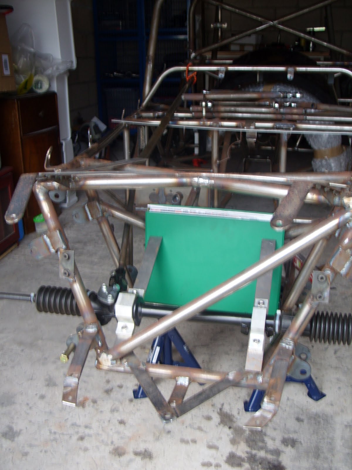

Here you go Steve mate, hope they are ok for you fella......
Caterham anti roll bar Green spec inc bushes and CSR mounting brackets
Welded mounting points into front corners of front hoop section
Bar mounted complete with rose jointed drop links, and radiator mounts trimmed round anti roll bar
Top mounting to anti roll bar
Drop link mounted to shocker lower mounting and nose cone refitted and trimmed round bar.
Total cost was below
£25 second hand new roll bar
£35 CSR mounting brackets
£60 Rose joints and turn buckle bars
£10 Misc nuts and bolts washers etc
£48 Anodised top mounts to bar
Welded paltes in myself so that bit was free
so in all £178 dont know if thats cheap but its done now

I've already fitted all the ARB mounts to Tim's Locost chassis, but I don't have photos of them fitted to post for you earlier as I
hadn't/haven't made the actual ARB's
Fantastic - however looks very different to how I imagined it to after seeing my friends mega busa westfield
