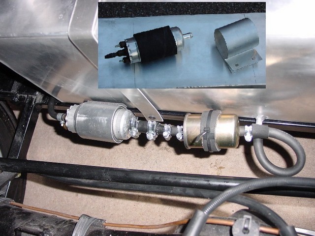

has anyone any pics of where they have mounted there fuel pump,

Here's how I did mine (for a fuel injected Rover K series) - bracket from bent ali + fuel filler hose insulation, bolted to the bottom rail under the fuel tank. N.B. I have since made a similar small rbacket for the fuel filter. Rescued attachment 2005-03-27 - 2 - ST fuel pump & filter fitted.JPG
