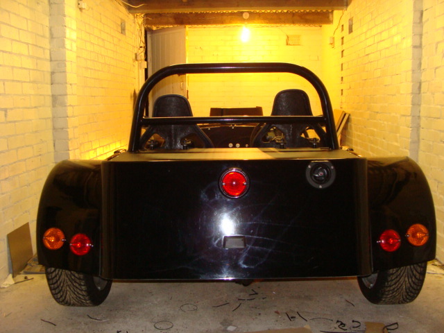

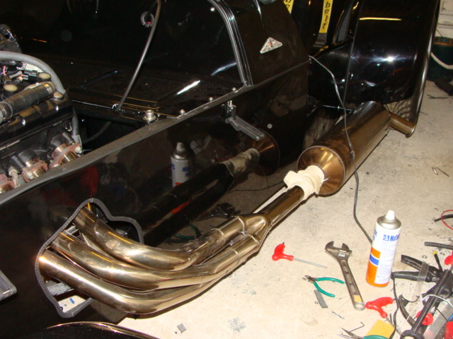

SVA look over ,please
can you guys n gals have a look over these pictures thank you

loose wires in the last pic.
Edited - you've added a picture as i wrote that. Loose wires in the one inside the car showing the steering wheel.

rear reflectors missing and 2nd method fixing for the mushroom, although not all sva centres are consistant with this, Beverley was though.
Looks good though mate.
Rich

Looks good! only thing, can't see any rear reflectors there.

those wires are the optimate charger and the reflectors are in the post, nottingham dont seem bothered by the mushroom fixing when i
rang............thanks keep em coming

Is that a vin plate just to the left of the air box? Do you have a welded or permanently stamped chassis somewhere else?
Apart from making sure all your mirrors and lights have the correct markings and your tyre speed ratings are above what you put down as the max speed
of your motor I can't see anything else.

can i stamp in the ally floor or does it have to be the chassis, maybe the diff carrier , nice and thick

Think I read somewhere if your floor is just rivited then its not deemed part of the chassis but if its bonded and rivited then it is, but check first
as this could be different from center to centre, is there nowhere a plate could be stamped and welded on?? If you are going to stamp it goes without
saying to make sure its packed and supported from behind whilst twating the stamp!!

We stamped ours on one of the flat steel cross members that go under the drivers seat in addition to an ally plate riveted as you have done.
You should be OK at Nottingham, helpful guys. Enjoy the day.

Sharp edge on top shocker mount, cannot see if its behind nose cone in pic.

Top Picture rubber covering top ball joint threads appears to be catching actual ball joint cover I wouldn't be happy as it could cut through
(and any split cover is a mot fail point so I guess an sva fail point as well
