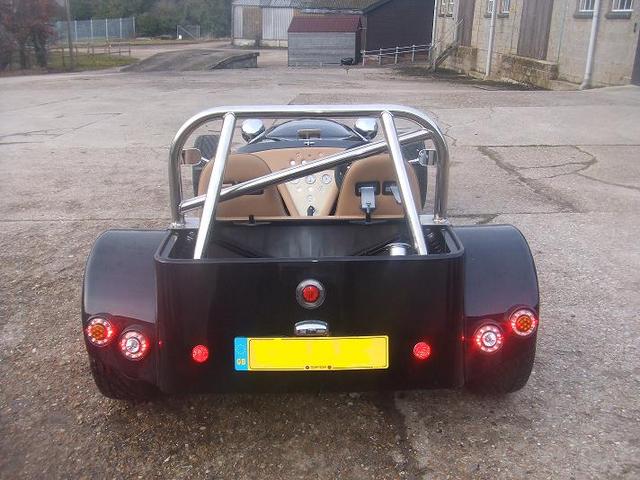

Evening all, just wanted to share my progress with you all and thought it was about time i posted some pics of my MK. I had what i would call my
proper first drive today and just felt the need to post up some pics, hope you like
obviously its not dressed for IVA yet i am yet to do all the trim etc i still need to make a boot lid and fit the front wings and fit a grille but im
nearly there

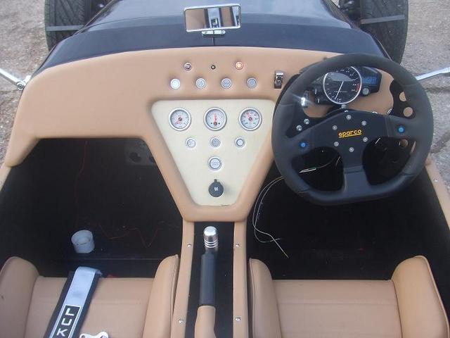

Looks a real top quality build,well done,love the wheels

Looks really really good, love the interior - not sure about the wheels but thats just my personal opinion!

just to clear this up i borrowed an old number plate off my brother to get an idea for the lights and reflectors just havent got round to taking it
off so its not registered or IVA'd yet.

Very nice, I really like it. You gonna post pictures just prior to IVA as there's a couple of things there you might not have noticed. The
reflectors at the back for one will fail. If you don't mind me mentioning.

Not at all would rather know in advance, can you say why the reflectors would fail?
If you notice anything else please say that goes for anyone, would rather sort the silly things in advance i know theres a few temporary things like
the harness mountings but any criticism will be taken in the right way

and the fog light needs to be vertical, just to let you know.

Max 400mm from the outer side ?
The middle light; is this fog+reverse ?

I seem to recall at SVA the reflectors had to be within a certain distance of the outside edge of the car?
Is your fog light Vertical. Again I at SVA it would be a fail if it was not total vertical.

ok so my spacings are wrong on the reflectors easily sorted i suppose could they go above the lights on the arches or below might look better if
theres room?
The centre light is fog with chrome outer ring

Oh, and your side indicators will fail too !
BTW: are those indicator buttons on your steering wheel and what type of steering wheel is it ?

Ok still not sure whats best to do with the side repeaters have read others have put them on the side of the front arch think this is what ill be
doing.
yes mate your right the buttons are used for the indicators heres a link for a site that sells steering wheel
here
I did have to buy some new buttons as the ones supplied are for a horn and are not latching but bought some latching switches off ebay for a few quid
and replaced them jobs a goodun!

The reflector edges don't have the required radius. That is of course unless you have them in plastic holders that I can't see.
I had the exact same ones and they were pointd straight out by the inspector.
Oh and the mirror mounting base is the same that Gav had and got picked up on.
[Edited on 28/2/10 by mistergrumpy]
corrado vr6
| posted on 28/2/10 at 10:26 PM |
Do you mean the rear view mirror, did it fail on radius? if so i what did Gav do if he has solved the problem already has he covered it or bought a
new mirror? thanks again
http://r1indy7.wordpress.com/
mistergrumpy
| posted on 28/2/10 at 10:38 PM |
Yeah the rear view mirror footplate that the screws go through. He stuck some rubber trim around the edges of it.
