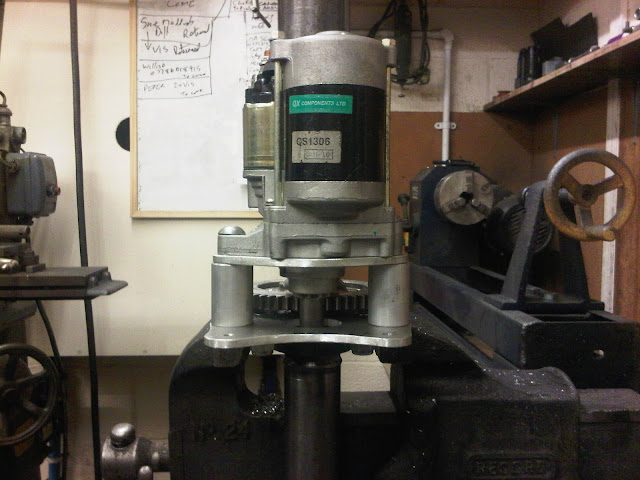

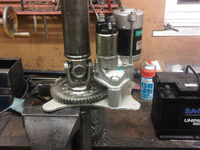

i have used a honda civic one, a remanufactured one on ebay. This is what i have done
more info on the blog
http://www.austengreenway.co.uk/search?updated-max=2010-11-25T08:44:00Z&max-results=2
I also have a spare gear if you want to buy it
Cheers Austen

neo2
posted on 3/1/11 at 09:53 PM Reply With Quote
Where is that going to be located in the line up front rear or middle looks quite large thats all and is it in middle joint ??
