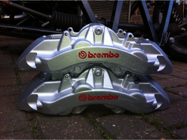

look at the size of your brake calipers. ![](/images//smilies/shocked.gif) ![](/images//smilies/shocked.gif) ![](/images//smilies/shocked.gif)

They are 8 pots from an E55 amg .... They were a good price..... I cleaned, painted them and as they are made by Brembo I have added Red brembo decals
in place of the AMG logo's. The brackets are being machined as we speak. It was an interesting engineering exercise to get mercerdes to match
ford fitment.

can the decals take the heat from the brakes? I've always found callipers get very hot

Too be honest... Probably not. Im sure I will have to touch them up with red enamel at a later date.
Although they are a big piece of aluminum and should dissipate a lot of heat.
