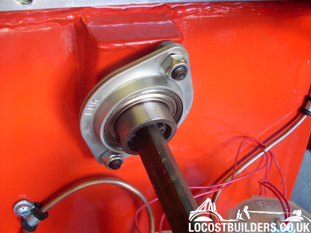

Should there be a bearing or something where the sierra steering column passes through the hole in the bulkhead?

There is a standard sierra plastic bearing that fits in the bulkhead but it's pretty crap. Suggest you take a look at this thread, it's a mod I will be doing this winter.

I use this one..
Ps not my pic.

Thanks guys, 1" bearing ordered on eBay.
