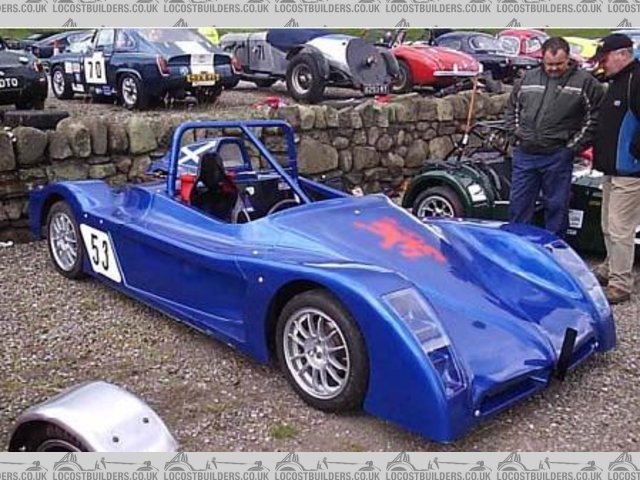

Is this the MK GT1 which has slowly morphed into the Spire GT-R over a few years and has been further developed by them i.e. Le Mans LMP2 style open cockpit car? if so seems a good kit and has done well racing.
GT1
Spire GT-R

The original gt1 (as far as I'm aware) was sold on and re developed by spire in GTR and GT3 forms, with great success in RGB and bikesports.
But there are some original gt1's still racing and they seem to be somewhat un-competative compared to the spires etc. Although I have no idea how quick the drivers are in the mk's. The spire drivers are very very quick indeed

A GT1 with bike engine should be a very, very quick track car but Ive heard handling can be "interesting". I understand the chassis/suspension geometry was improved for the GTR resulting in a significant improvement in handling.
I wouldn't take much notice of the performance record of RGB cars, most competitive RGB cars are highly developed and bear little resemblance to their road going cousins.
I don't think anyone has put a gt3 on the road, Spire sell them as race cars.
Ive not been in a GT1 but given a GT1 will cost about the same as a GTR I'd try and find a later car.
