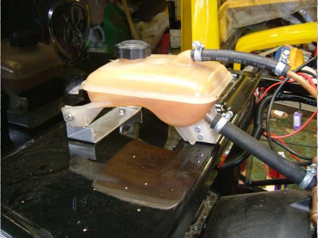

Is the bendy looking pipe (convoluted?) from the top of the rad an of the shelf item or cut to length of a roll so to speak?

| posted on 9/1/05 at 10:10 PM |
the pressure valve releases through the cap as in the sierra. when it blows, it blows all over, not down a pipe as such, like with an expansion tank.
i don't know what pressure cap it is though
still, i'm happy with mine and it does'nt run hot particularly, even revving stationary.
tom

I f it does great, I am perhaps behind the times looking for a springy cap

ReMan
| posted on 9/1/05 at 10:53 PM |
Thanks Hellfire, nice pic Indykid
Why the 400 tank anyway?
indykid
| posted on 9/1/05 at 11:16 PM |
its got an 18mm outlet to suit a pinto water pump and an 8mm for the air bleed from the top of an MK mk2 escort (custom added penny) radiator.
i looked round the scrappy and sort of stumbled across it. it was either that or a golf/polo one but they seemed a bit bulky
hth
tom
