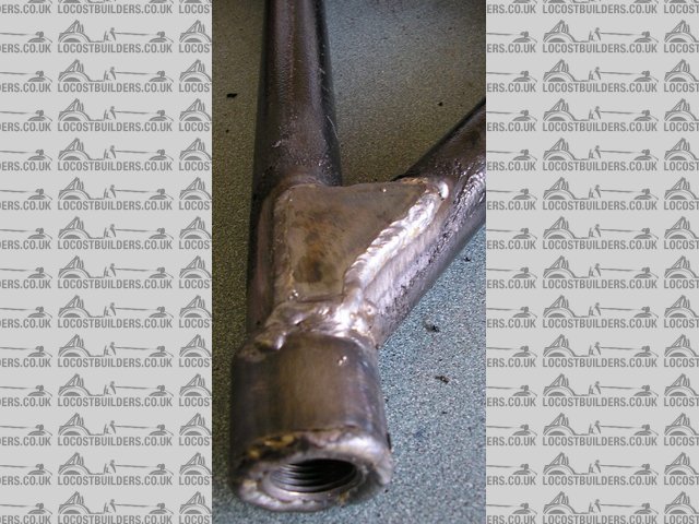

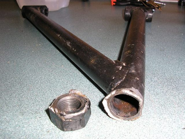

Went for a run in my plan built F27 on Tuesday , and as I was approaching a junction, I heard a loud "POP" and the off side front wheel canted over and locked up.!!
On checking what had happened , the weld around the nut on the lower wishbone had snapped!!!
This has happened to at least one other F27 owner ( Bruce Jackson ) that I am aware of ,
I am sure that this could happen to anyone else with this type of designed lower wishbone.

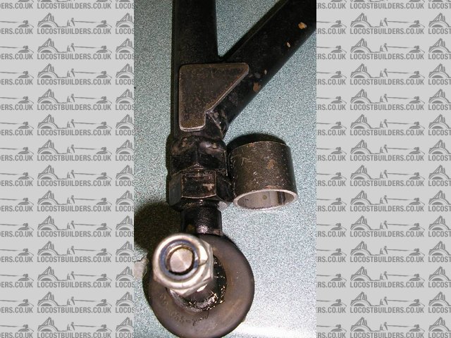

PLEASE can the F27 owners / builders check their wishbones , and carry out the strengthening suggestions that I have just completed ( photos in my archive )
Luckily I was travelling slowly and there were no injuries , Damage wise , I have had to replace the steering rack ,as it had pulled one of the racks out by 20mm!!
Luckily I had a spare rack in my garage!!
If this post helps to avoid even a single accident or injury then I will feel good!!
I'll try to post a pic or two now!
F27 lower wishbone snapped
F27 wishbone strengthening par
F27 wishbone underneath

Looks like a severe lack of penetration. I wonder what the rest of the welding is like

Weld looks to have barely attched the nut to the bone tube. There is surely a better way to make these things? Just out of curiousity, how do the inserts weld in? I've never seen one up close before.
posted on 4/6/06 at 08:53 PM Reply With Quote
Your going to have to remove a lot of that outer weld to get a flat surface for the lock nut to seat against. I'd be tempted to drill a couple of holes though the side of the tube and put some plug welds in for extra security. A proper threaded insert would be better again.
ChrisGamlin
posted on 4/6/06 at 08:55 PM Reply With Quote
A much better way to do it would be to make up a long threaded insert that would support the entire length of the ball joint, then slide that inside the tube and weld it in. You'd probably puddle weld it in as well so its welded at both ends of the tube.
DIY Si
posted on 4/6/06 at 09:13 PM Reply With Quote
So, do you buy the inserts or make them? Never treid to find any before. Would you normally put plug welds down the length of them or not?

posted on 4/6/06 at 10:53 PM Reply With Quote
Hello...
Forgive me for being critical, but I dont think that strengthening is going to do a thing! The weak point is still exactly the same as it was before - where a nut is welded onto the end of a tube. That plate may help the wishbone as a whole but wont help the weld that failed at all. And the sleeve over the two nuts also wont help the weak weld - the inner weld of that sleeve is simply on top of the weld that failed. No part of that strengthening has actually strengthened that original weld imho. I think the only way to do it is with threaded inserts like everyone else has suggested.
