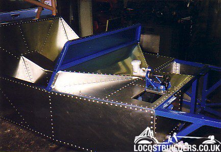

Hi i do love a good excuse to bring this photo out. 1" spacing and a verry good quality bonding sealer is the only way to go.
[img]http://locostbuilders.co.uk[/img]
cheers Matt

Rivet PORN
