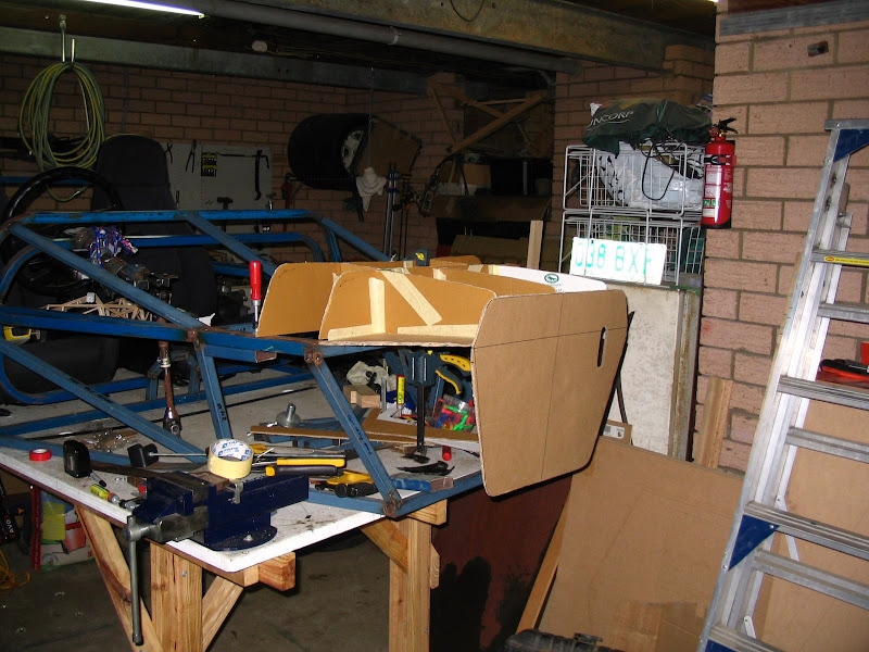

As for duct shape - the biggest and most direct you can fit in your bodywork design I'm building to a classic clubman profile (pic below)
and that gives me a quite good rad opening right at the front. That model pic doesn't show it but there'll be exit vent/s on the top of
the nosecone/bonnet area, Caterham CSR style, as well as venting out through the suspension area.
Delinquent's pic of the Ultima also underscores the other important point - make sure all of the air that comes in is forced to go
through the radiator and not around it. It amazing how often this simple rule is forgotten.
