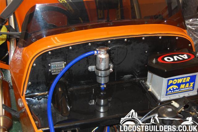

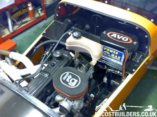

Done some mods over winter, heres some details+pics
Replace the Sierra Header tank with a nicer ally one, and relocated the fuses to the bulkhead
before

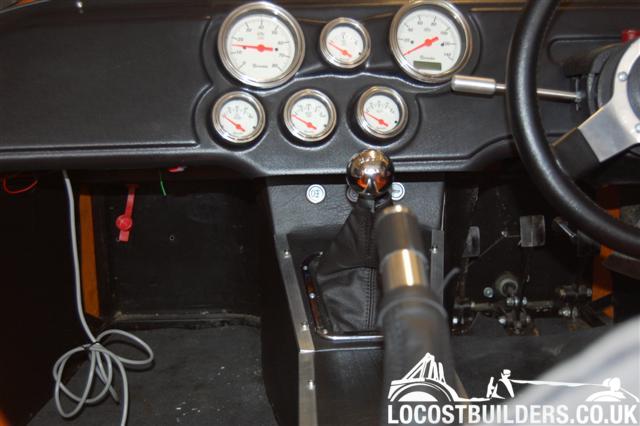

Wasn;t happy with the dash, so re-did it along with the tunnel top,Gear/Handbrake gaiters / new stalks and centre mirror
before
After
fan/fog/horn switches tucked away..

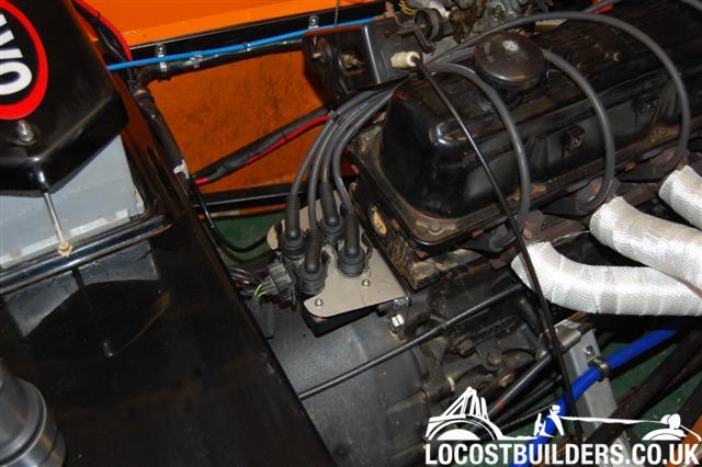

also converted to megajolt, so fitted the coilpack...

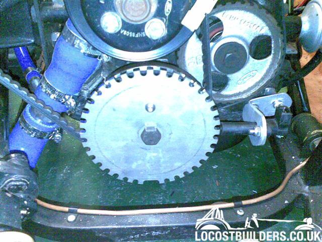

and VR sensor/trigger wheel........

Looks good Ray - a very tidy job once again (as I find your work to be!). Now you just need to fit a bike engine next winter!

Where did you get the stalks and handbrake sleave? I assume they are sierra. I want!
