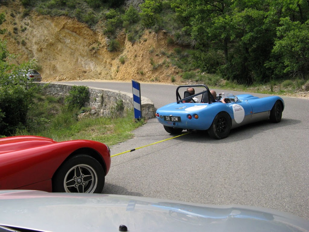

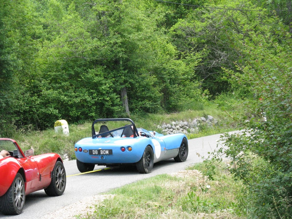

Jim Giblett had helpfully put a towing eye on the rear of the chassis on his Phoenix (that Lee now owns). It was used twice on this years Alps trip
Who says BEC's aren't practical
My car (killed gearbox):
Jim's car (killed driveshaft):
