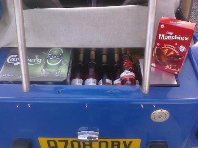

rallyingden
| posted on 22/6/11 at 08:37 AM |
Like this ...........
  Boot Box
Enough room for esentials
  Shopping
RD
