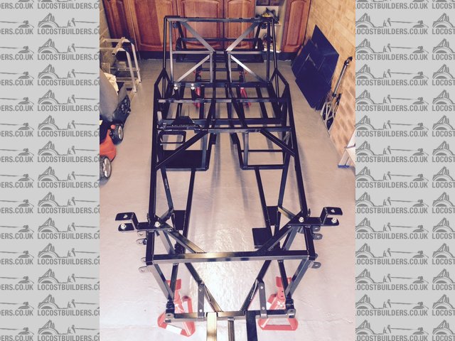

Chassis has arrived
  Chassis

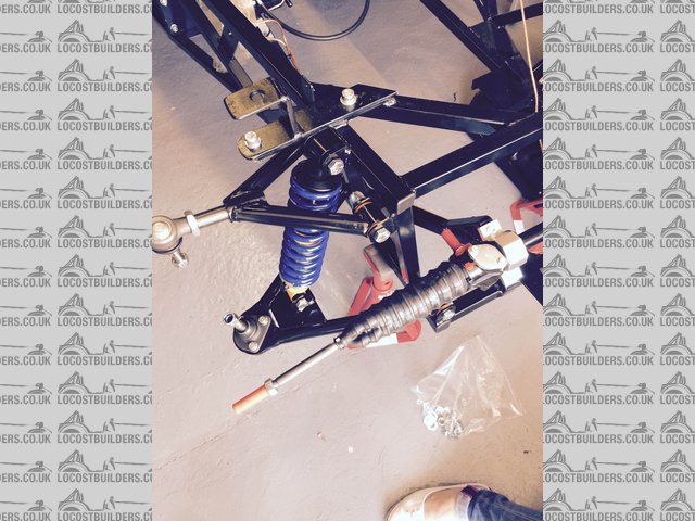

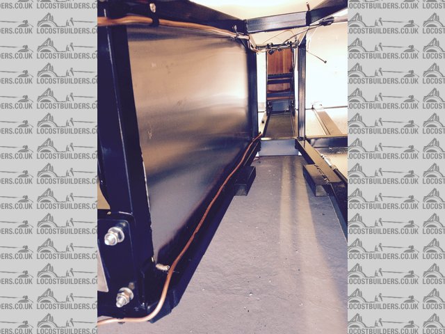

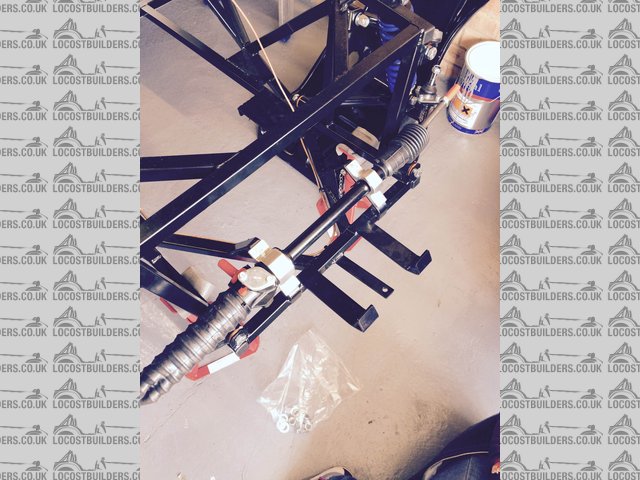

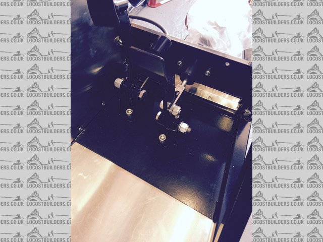

| posted on 20/7/15 at 01:48 PM |
Quick pic upload.
[img]
