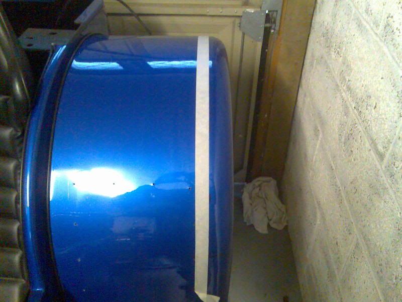

I just won a set of 17 ins rims with two very good tyres +two buggered ones off e-bay, they usualy retail over £600 big ones i got them for £101 sorted!
Only they fit perfect on the front as the wings were set up for et40 these are et38 but no chance at the back so i have made the decision to mod the arches.
I am going to(already started)widen them so they are both as wide as the wide bit at the front of the passenger wing, that gives me just enough clearance, its making more work but the end result will be worth it(i hope).
Will post some pics as i go.

macnab
posted on 19/2/07 at 08:05 AM Reply With Quote
done this already by 6in at the rear. quite easy.
soggy 3
posted on 19/2/07 at 09:06 AM Reply With Quote
Six inches!! i bet thats what you tell all the girls
which method did you use to join them?
macnab
posted on 19/2/07 at 09:13 AM Reply With Quote
here's what I did after fitting 295's to the rear -
1) cut right round 3in from the inner edge
2) used marked up balsa sticks glued to the inside to space out the gap
3) glued think waxed card to the outside surface
4) removed the balsa and applied 2 layers of glass cloth followed by 1 layer of CSM.
5) heated up the card with a hairdryer and pulled off the card then wiped the outside down the white spirt.
6) sanded down the outside to finish.
only took two nights to complete, 6inch's thats rather small...
[Edited on 19/2/07 by macnab]

posted on 24/2/07 at 11:37 PM Reply With Quote
Marking out.
soggy 3
posted on 24/2/07 at 11:39 PM Reply With Quote
Cutting!!
soggy 3
posted on 24/2/07 at 11:40 PM Reply With Quote
Glassing.
soggy 3
posted on 22/3/07 at 04:49 PM Reply With Quote
Been a bit slow updating this but one side is done just need to do the other.
