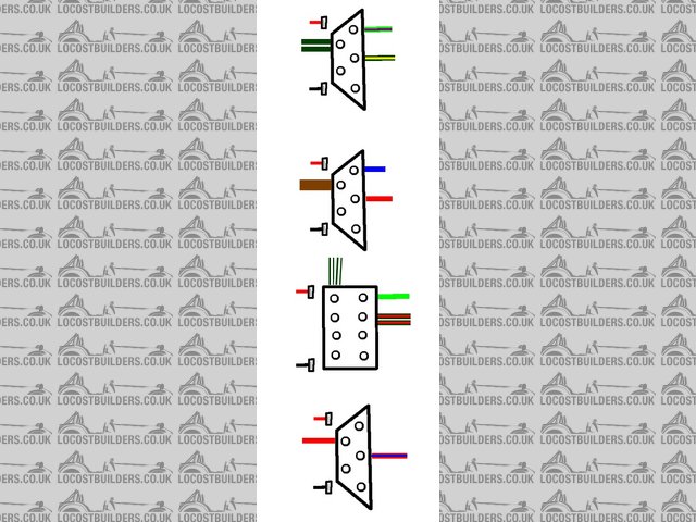

Hello all,
making progress on my wiring but hit a brick wall with deciphering what some plugs are I’ve got 4 plugs all in the same bundle (diagrams below)
3 X 5 hole trapezoidal plugs and 1 rectangular 8 hole plug
Each of them has a red and black flat plug accompanying which logic would tell me is supply and earth
tiger plugs?
tiger plugs?
So in words its
B = BLACK
N = BROWN
R = RED
U = BLUE
P = PURPLE
W = WHITE
G = GREEN
LG = LIGHT GREEN
Plug 1
LG P
G X2
G Y
Plug 2
U
N (thick Brown)
R
Plug 3
G W X2
LG
G R X2
Plug 4
R
R U
Basically… what the hell are they and what do I do with them? Help?
Thank you please.
Nath

Paul TigerB6
posted on 13/10/08 at 12:33 PM Reply With Quote
1st one - heater???
2nd one - lights (side / dip)
3rd one - hazards (g/w & g/r give it away as these are standard colours for indicator circuits left and right)
4th one - fog light
Tiger use the standardised colours throughout their loom
djtom
They go to the dash switches. Can't remember which is which at present, but at a guess they are for main / sidelights, hazards, fog, heater fan, etc.
The seperate red / black spade terminals are for the switch illumination - i.e. the switches light up when the head/side lights are on.
Diagram here, but I can't vouch for it's accuracy!
http://homepage.ntlworld.com/steve_randle/Tiger%20wiring%20diagram.htm
HTH
Tom
nathanharris1987
posted on 13/10/08 at 12:50 PM Reply With Quote
i agree paul that makes sense but then i found a diagram stating what went into the sierra stalks with the dipped headlights already mentioned?
Cheers for that diagram dj tom its bloody useful! everything is making sense slowly.

Paul TigerB6
posted on 13/10/08 at 01:58 PM Reply With Quote
Pretty sure the Sierra stalks wiring only contain the Main Beam switch.
If you look at the blue wire coming out of the lights plug, it should run to a 5-blade changover relay (onto pin 30) of the Tiger loom. The main beam switch will then be connected via pin 85 or 86 to the Sierra column switches.

nathanharris1987
posted on 13/10/08 at 03:38 PM Reply With Quote
Rigghht, so all those wires i plugged into the sierra stalks... only the inidactors and main beam functions of the stalk will work?
the rest like hazard, lights and fog switch will have to be seperate on the dash?
ta
Nath
Ps havent got heater or window wipers so just cut that stalk off.
Paul TigerB6
posted on 13/10/08 at 03:52 PM Reply With Quote
From memory (building a Supercat earlier this year), the Tiger loom uses the column switches for the indicators and wipers only as normal. Did you get any rocker switches from Tiger at all??
Have a look at the Tiger 12 fuse wiring diagram on the following site under "Documents". It shows the main beam switch on the column switches as well as the rocker switch that Tiger supply that fits the plugs (Delta Switches as per Premier Wiring's website)
Link for wiing diagram
Link for Premier Wiring showing Delta Switches
[Edited on 13/10/08 by Paul TigerB6]
DaveFJ
posted on 13/10/08 at 03:58 PM Reply With Quote
I can only speak for the 6 fuse loom - which I assume you have as it is an Avon.....
The loom uses the wiper and light/indicator stalks on the standard sierra column. The light/indicator stalk operates the indicators (obviously!) and the hi/lo beam. It can also be made to work as a flash if you supply a seperate 1+12v to one of the spare pins (cant remember which but a quick search on here will tell you)
Hazard and side/main light switches are designed to be seperate on the dash - they will have been supplied if you have a full kit....
HTH
Dave

nathanharris1987
posted on 13/10/08 at 04:26 PM Reply With Quote
ive got the 6 fuse loom
would it be too much of a job to route the side lights switch into the old light stalk on the right?
also i take it i need an extra "flasher" module if i want this function?
ta
nath
DaveFJ
posted on 13/10/08 at 04:32 PM Reply With Quote
flasher - is built into main / dip switch - you just need to supply an extra +12v
Dave
Paul TigerB6
posted on 13/10/08 at 04:35 PM Reply With Quote
Should be pretty easy to wire in the lights to the column switch if thats your preference like that. The brown wire is simple a common supply for the lights so just need to work out where to connect it on the standard Sierra lighting switch plug, along with the feeds for side lights (red) and dip / main feed (blue/white).
The main beam flash is already part of the indicator switch anyway isnt it, along with the mean beam switch on the left hand column switch??
