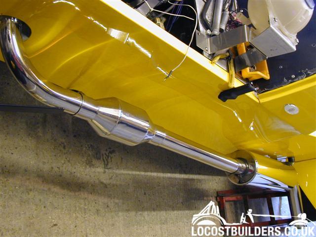

This is what I'm gonna use for SVA etc.
Was a Jag one and I've had cones welded on each end.
Pat...
Yes I've used one But NOT on a BEC and NOT with carbs.
LOOK
Passed emissions on SVA
<0.45 at Idle and <0.3 at 2500 - 3000
Worked fine on Injected Zetec.
