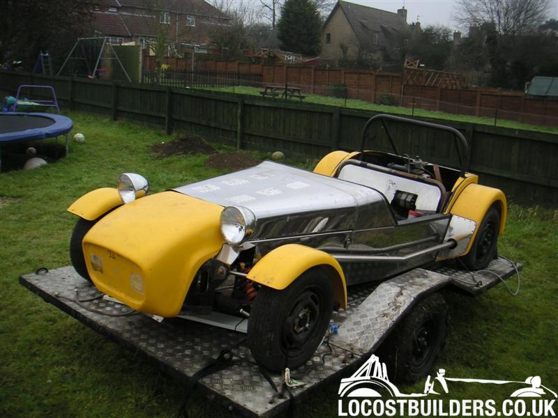

This is my trailer im making out of a caravan chassis. Its only a few inches wider than my locost so would definatley fit in a garage.
Sorry for the piccie size. I have reduced it aswell.
Looks alot different to that now but havent got a pic. Itl probably have cost me 100 quid when im done.
I think that is the route I'll go down, at least then i can design it around the locost.
