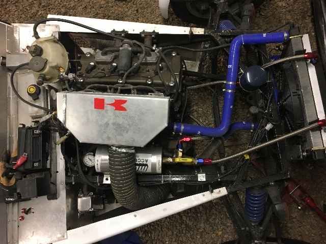

| posted on 13/5/18 at 08:48 AM |
here's mine
