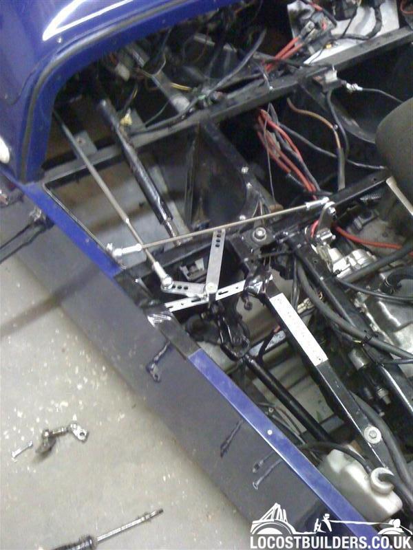

Hello all,
Just wondered what people's thoughts are on mounting the cam for paddle shift sideways, as in the pic below? Reason being it seems to allow the rods to move more freely etc...
Obviously a trial fit!
Hopefully get this put on properly this week
Lee
Steve Hignett
posted on 23/6/09 at 11:12 AM Reply With Quote
It makes no difference which way up it goes...
welderman
posted on 23/6/09 at 12:17 PM Reply With Quote
yep i would say thats ok too, im sideways at the moment.
Thank's, Joe

g.gilo
posted on 23/6/09 at 03:47 PM Reply With Quote
cam
hi there
just for your info, a link or lever that changes direction of a motion is a bell crank not a cam.
here endith the lesson.
good pics, i must think about changing
from a floor mounted lever.
regards graham
mad-butcher
posted on 23/6/09 at 05:35 PM Reply With Quote
Aren't you going to get a lot of travel at the paddle with levers that long. from memory mine are about 2" long.
tony
