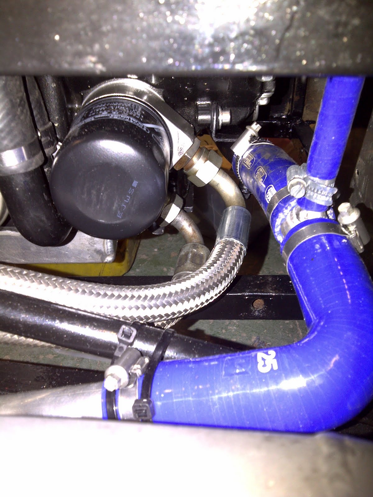

Yes it is, direct from the cooler to top hose.
The only other mod needed for that sarnt plate is that the metal coolant pipe that comes out of the water pump needed to be bent out slightly and the
spacer added you can see inn the picture, but that may be different on yours depending where the engine is mounted as the chassis rail was causing
clearance issues with the cooler pipes, so had to rotate it
