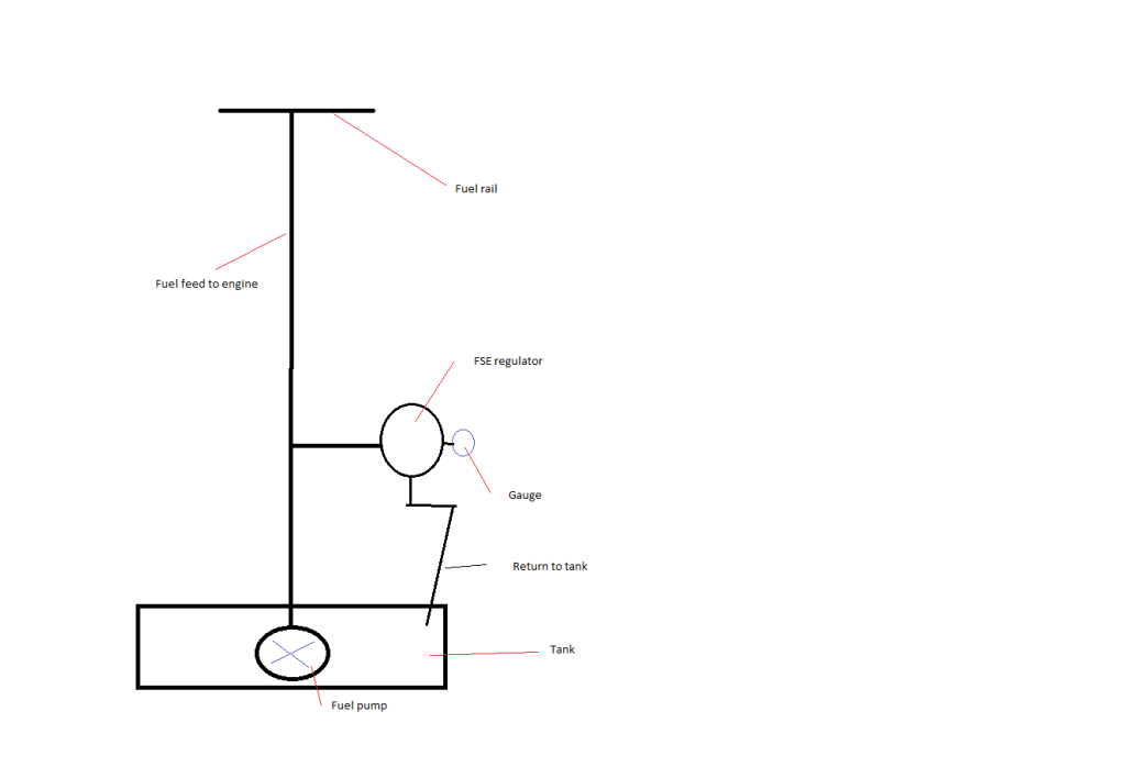

An FSE AIR004 will work and you can screw a gauge into the spare fuel inlet port on the side. This is how i plumbed mine in as the hayabusa only has a feed to the rail and no return. The regulator and gauge are mounted just above the diff so you only need a very short return insteadof all the way back from the engine bay.

However, shouldn't the fpr be mounted in line rather 't'eed off (as shown in your pic) as its not going to regulate the fuel pressure that way?
AS long as it's controlling the only return to the tank then it's fine, it'll still control the pressure in the line. Picture it being an open pipe, then as a plugged pipe, the pressure at the injectors will still be affected.

Mine is a standard in-tank pump and fuel rail from a 2002 bike. Is yours an early one with an external pump? It works perfectly with the fpr set up like this.
