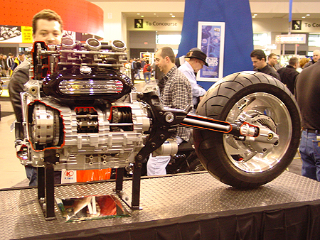

| posted on 24/3/13 at 05:56 AM |
It's a Triumph Rocket engine. A wee bit of an oddity as its mounted longitudinally.
It's Evolution Baby!
| posted on 24/3/13 at 06:12 AM |
