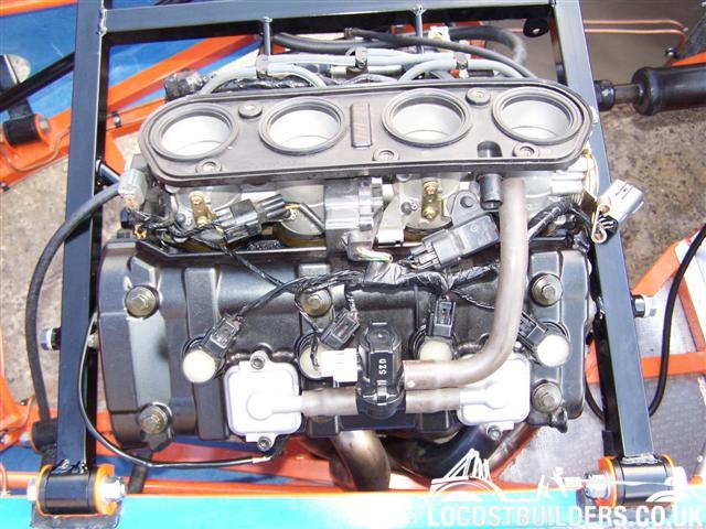

jacko
posted on 14/1/08 at 08:14 PM Reply With Quote
Hi if you look at Roadrunners photos on here under zx9 engine you will see how i did his engine cradle solid fix like MK
Jacko
