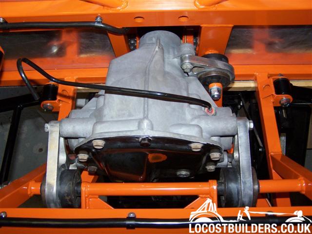

bigrich
posted on 5/2/08 at 09:59 PM Reply With Quote
freelander diff is a 3.21 ratio, which is great for the zx10r motor.
Mine is mounted using the O/E rubber mounts to reduce vibration and transmission noise
you will need different mounts and conversion driveshafts with landrover inner joints and sierra outers to fit into the hubs etc
The early diffs have a reputation for failing brgs but as joel said it was caused by the even more troublesome 4x4 system, so in a 7 it would probably be ok but to be sure i would search out a larger brg diff
i bought 2 complete rear ends and paid 80 quid each so they're not too expensive
Rich
