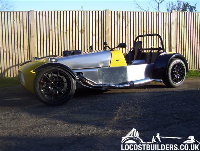

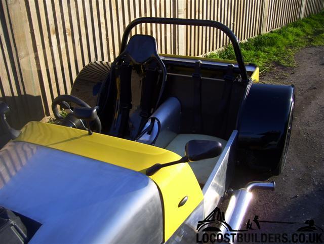

PS some better Pics for those interested.
