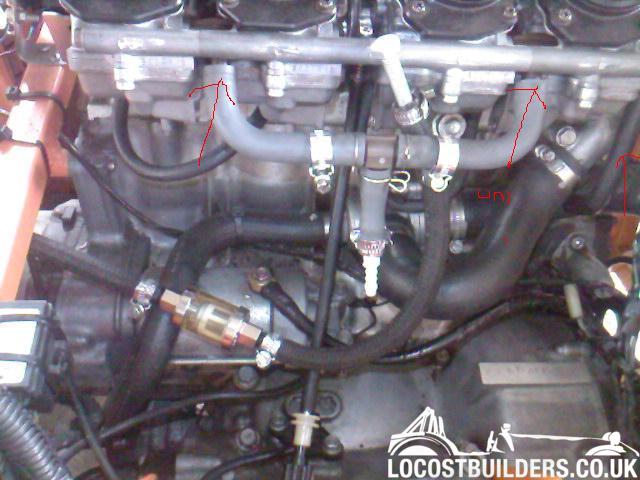

hi all
im back again still with carb probs,after the last issue ie flooding the plugs especailly number two, i got them sent off to andy at ab performance,he
washed them through and put them back together again with the same dyno jet kit ect.fitted the carbs on today connected the fuel line turned ign on
and waited to see if the fuel pump cut of after filling float bowles still clicking away after 10 mins ,now ive also got the added problem of fuel
p,,sing out of the plastic unions that feed each pair of carbs and ive got fuel pumping out of the overflow pipe/breather on carbs,the leaking problem
didnt have before so im wondering if the pump is up the creek or if the seals to the unions if it has any are damaged ?? cant speak to andy till
monday wondering if anyone eles can throw any light on it.
i wil try and post a few pics of the set up
all fireblade pump ect 919cc
thanks
simon.jpg)
mkblade
| posted on 19/7/08 at 11:17 PM |
pics
.jpg)
mkblade
| posted on 19/7/08 at 11:18 PM |
pic
.jpg)
mkblade
| posted on 19/7/08 at 11:22 PM |
i have put some red arrows to show where i think the fuel is coming from
cheers
simon.jpg)

shouldnt ther be another couple of jubilee clips at the points you are showing > ??

I take it that the two jubilee clips that look loose are for the place where you have arrowed???
I also take it that the main fuel hose in that has a white bung, is done so temporarily while you had your carbs off???
I would also be willing to bet 5pence that the fuel isn't coming from the brown plastic unions that you have arrowed, but that it is coming from
some secondary brown plastic overflows just behind those ones you have arrowed. Of course without being there I couldn't know for sure...
Even though I'd usually believe Andy's work was pretty spot on, it can only be a couple of things at this IMO.

Mine leaked at the point you show on the picture. I got new "O" rings for the plastic "tee" pieces from a Honda dealers and it
cured the problem. Look in the Haynes manual. The pump will continue to run all of the time the fuel can escape. You will also need clips for the
pipes shown.
Barry
mkblade
| posted on 20/7/08 at 11:00 AM |
the lose jubilee clips are the ones that fit where the arrows are,the plastic joining peice is a reducer to get the blade fuel pipe and my new fuel
pipe to marry up together,pics were taken on strip down again.

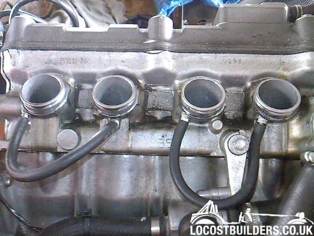

OK I'm 5 nights into a 6 night shift, but in the first picture aren't they the vacuum gauge pipes you've got linked in pairs on my
blade and R1 these are blanked off and only used when setting up the carbs using 4 vacuum gauges. if they are open and linked in pairs surely it means
the carbs are going to be pinching extra air off each other 1 & 2, 3 & 4 ie running weaker.
Just an observation
tony

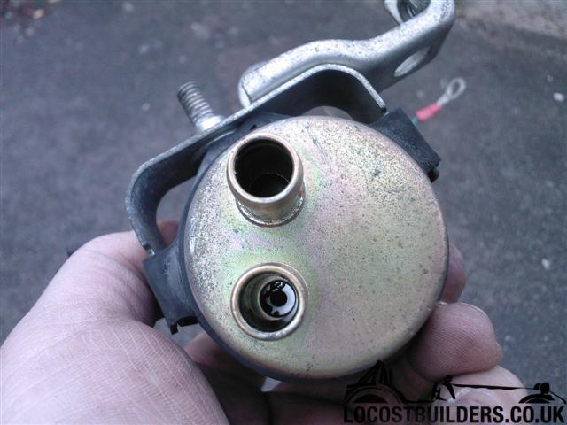

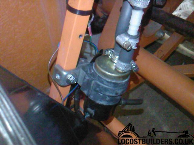

mkblade
| posted on 22/7/08 at 11:21 PM |
update
i blocked of the fuel line last nite turned the ign on pump clicking away and still clicking 10 mins later no fuel leaked im sure it should of cut off
(pump)
pump wired straigt to ign live (no relay)
ive attched two pics the pump has two pipes the one which is slightly restricted feeds the carbs and the other end comes from the tank .
have i connected it up right ??
thanks simon.jpg)
