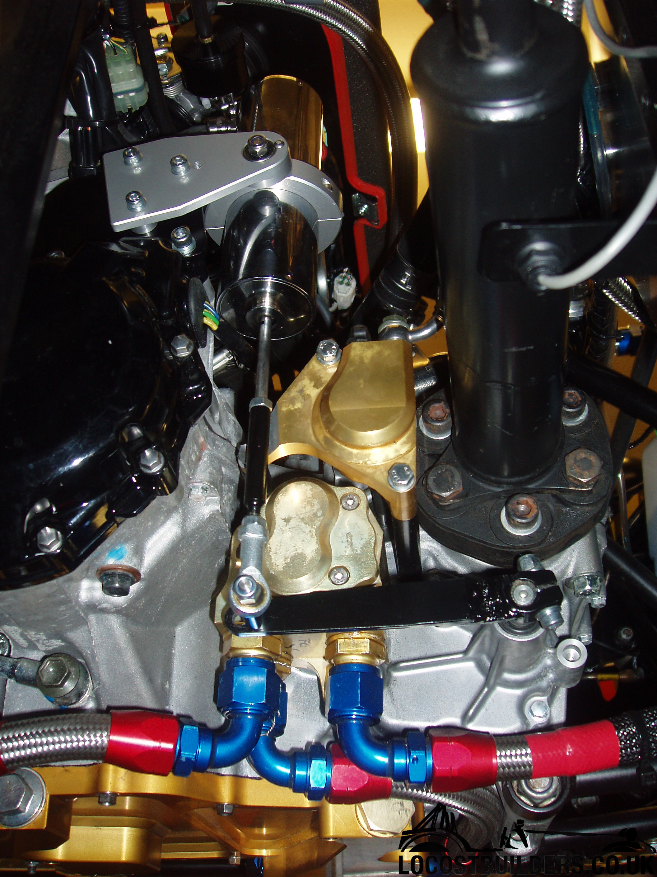

I have sorted why my BEC wont engage first gear and its because the whole linkage is too heavey for the Klictronic to lift aswell as putting it in
gear.
I can make some ally bits in place of some steel ones but I need do to get a long gear arm cut out of 3mm titainium. Basicly it's 130mm long,
about 20mm tapering to about 15mm. Is there anyone out there that can do this or recommend someone who can? I'm happy to pay a fair amount to
get it done.

Jason Fletcher
| posted on 23/1/09 at 07:28 PM |
I need it rigid because there is a lot of side load on the arm so drilling holes may cause other problems.
I had thought of a counter balance and yes this would work as there lots of room to fit it but if theres a chance of getting a titainium one made then
it would jet be the perfect job.
heres a pic of the problem gear linkage

Minitici
yes but I have a 5mm steel at the moment which is 7800kg /M3 so with 3mm titainium I would be saving about half the current weight.
