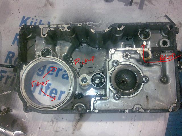

| posted on 4/2/09 at 01:55 PM |
After having the sump off, i can't really see any way (or real reason) to baffle!
The oly place the oil could go is upwards into the gearbox... but thats so high up compared to the pick up... Do i really need to do it?
If so... any idea?

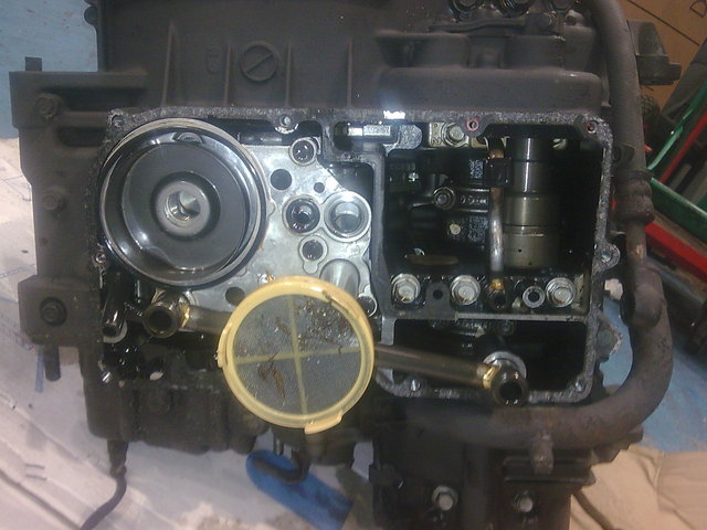

Norledge
| posted on 4/2/09 at 01:56 PM |
And engine side...
www.built4track.co.uk - cheap track days and the like!

adithorp
| posted on 5/2/09 at 01:41 PM |
When you corner hard (on a long corner especially) all the oil moves to one side and up toward the gearbox. Leaves the pick-up sucking air. It
doesn't happen in the bike because the bike leans in the corner and the forces are resolved through the centre line, just like the bike was
going in a steight line.
The fact that it has happened to people should be all the proof you need.

Norledge
| posted on 5/2/09 at 02:20 PM |
adrian
Yes i understand that, but due tothe design of my zx10 sump, the main return from the gearbox is a lot higher than the pump pick up... Wondered if
this really needs one...
