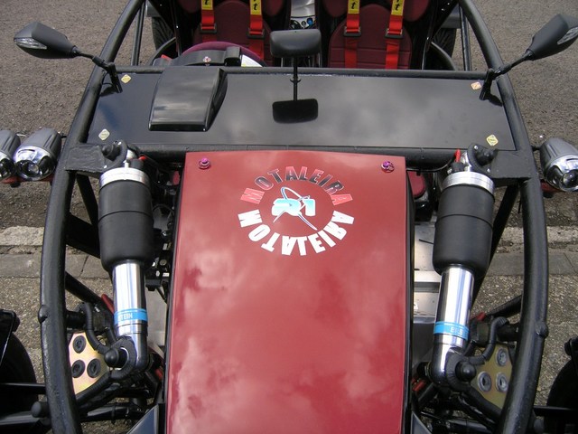

nitram38
| posted on 28/3/09 at 03:46 PM |
MotaLeira SVA Ready!
Apart from drilling the bias bar, the MotaLeira is ready for it's SVA.
Also even because of sva issues, I've removed the bubble screens because I don't like the distortion through them.
Plenty of jobs to do after it passes like plastic wrapping the side panels and mounting the sat nav.
Anyone got a trailor and some land?
[Edited on 28/3/2009 by nitram38]

| posted on 28/3/09 at 04:03 PM |
Just love the big front shockers,I think it will be nice to watch those working whilst driving down the road
nitram38
| posted on 28/3/09 at 04:07 PM |
Surprisingly, I can't see them.

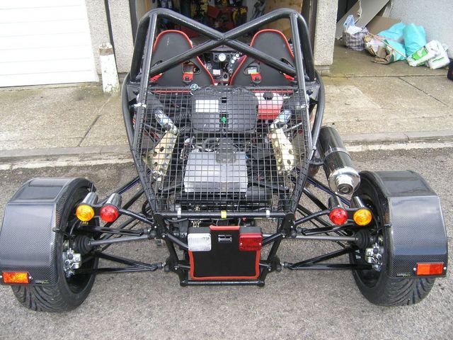

adithorp
Nice! I like the name and reflection sticker.
Couple of points...
Side repeaters; I know you've put extra ones on as well as the mirror ones but you can't see them from the camera position in picture 3
and I think thats within the visability arc.
Bonnet pannel fixings; Are they radiused enough?
Engine cover; Are the wires thick enough for the openings in the mesh? I'm sure there's something in the book about it but can't
remember the details.

nitram38
| posted on 28/3/09 at 04:13 PM |
Re the repeaters, I have a spare set of stickes that I will probably put on.
The mesh is fine as it passed on my previous car and it is correct because it is what Michael at Mitcham sva told me to use.
I'm trying to souce some different allen key dzus for the front panel. If not, I'll stick a cap on them.
iiyama
| posted on 28/3/09 at 04:33 PM |
Just failed at Southampton due to having indicators in the mirrors. Because they arnt 'wrap arounds', ie you can only see them from the
front, they count as front indicators. You are only allowed one set of fronts and even though I pulled the connections under the dash I was still
failed because and I quote, '9.2/ optional front indicators fitted to miriors fitted in addition to the maximum number fitted. Optional front
indicators not permanently disconnected'
This sentence didnt make much sense to me so I rang and asked for clarification, hence I was told about the wrap around feature.
Basically another SVA hoop jump as I cant see what difference it makes that you can see them from the side or not, ie modern production
vehicle's 'wrap round' side repeaters can still be seen very clearly from the front so in effect they have a pair of indicators per
side which is in contravention to SVA rules.
Think Ive rambled a bit but hopefully you get the idea!
[Edited on 28/3/09 by iiyama]

nitram38
| posted on 31/3/09 at 12:32 PM |
More Pre-sva photos.
Side repeaters arrived today and I put some silicon hose on the jubilee clips holding the rear mesh on. There will be caps going on the headlight
adjusters.
They are bound to find something I've missed.
The jubilee is in clear silicon but the flash has wiped it out!
