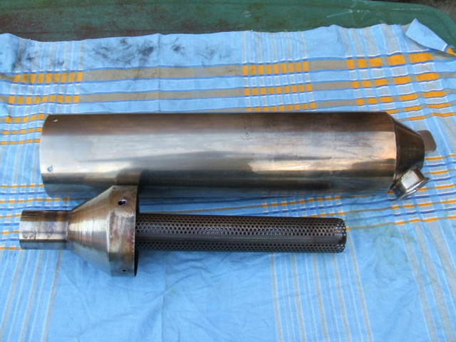

slimtater
posted on 19/4/09 at 07:32 PM Reply With Quote
May need to replace!
Anyone recognise this silencer? Is it pretty much a normal standard "off the shelf" item?
Silencer 2
Silencer 2
Silencer 3
Silencer 3
Silencer 6
Silencer 6
http://www.picturetrail.com/sfx/album/view/19919222
easisatman
posted on 20/4/09 at 06:53 PM Reply With Quote
well if you buy some let us know how it is as I have repacked mine with the stuff from cbs and was no different.
