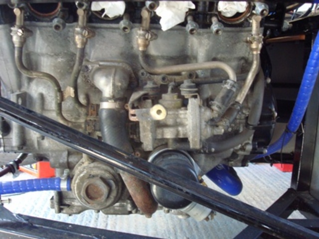

To make more room in the engine bay i want to take out the AIS on my 2001 r1 engine, is it as simple as blocking up the 4 exhasut ports and then

Yes it is that simple to remove the AIS system, just remove the unit, pipework & plug holes in exhaust ports.
Heres a photo Ben to whet your appetite for the turbo conversion, its my R1 motor a few days ago just before I dropped it back into the car.
Garrett GT28RS roller bearing Turbo (quite big), Tial MV-S 38mm external wastgate & big A$$ K&N filter

Now that i do like. Any pictures of the manifold?
