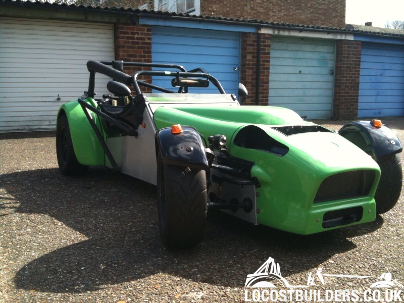

Finally finished my winter upgrades and got my car ready for RGB racing this sumer
http://www.locostbuilders.co.uk/photos.php?action=showphoto&photo=buitd1.jpg
Upgrades include
T45 roll cage, 3.38 LSD, ALloy racing radiator with ducted nose cone, all the safety stuff, removable steering wheel, anti roll bars, 13"
wheels, capri uprights, 6 point harness, foam seat, fully rose jointed suspention, flat floor and rear diffuser.
I must say it was fun when I took it out

TimC
| posted on 30/3/10 at 09:23 PM |
Well done on all the hard work. A couple of points however...
- RGB Regulation (Electrics) 5.10:1 says that the headlamps in your picture are of insufficient diamater. Its a daft rule as 'we' are at
an aerodynamic disadvantage anyway, but your headlamps need to be 5.75" in diameter.
- When you say diffuser, you don't mean something with vertical slats do you? I can't tell from your photos but Bodywork Modifications
Prohibited 2.3 tells you what you can't do.
Anyone would think I researched this sh1t! You a late entry for Mallory? Coming to watch, so I'll come and say Hi if you are.

marmot0
| posted on 31/3/10 at 07:13 AM |
Thanks for all the nice replies, it has been 7 months of hard work to get to this stage,
Tim thanks for letting me know about the headlights must have fallen asleep by the time I got to that part, and no it's not a diffuser just a
rear undertray. Won't be at Mallory but should be at Brands. Will come and say hello

marmot0
| posted on 31/3/10 at 08:09 AM |
Oh and about the headlights, I think they will be OK have checked the rules and it says 5 " headlights or equivalent surface area. The ones I
have fitted are vey bulbus so I think they have sufficient surface area
TimC
| posted on 31/3/10 at 08:15 AM |
What it actually says is:
Where cars are fitted with ‘cycle’ type headlights they must be a minimum of 5¾” diameter or equivalent surface area if not circular.
I'd be pleased if the rule could be changed, but that won't happen for this year I would have thought.
ETA: Chris, as I have an interest in this as well, I'm going to raise the point on the RGB forum.
