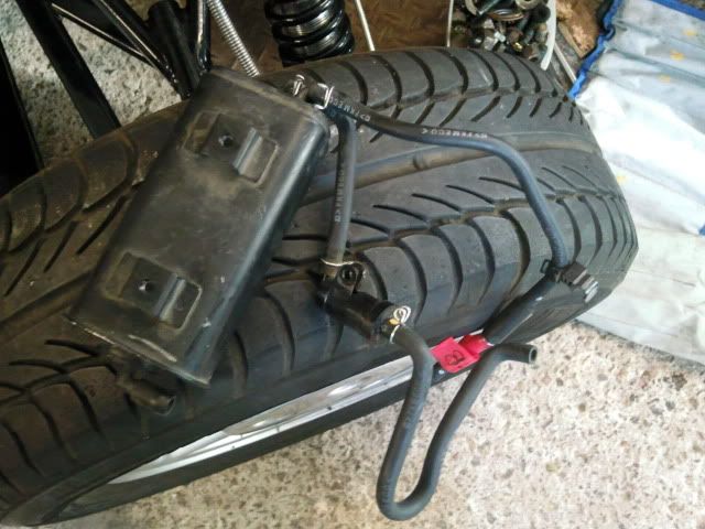

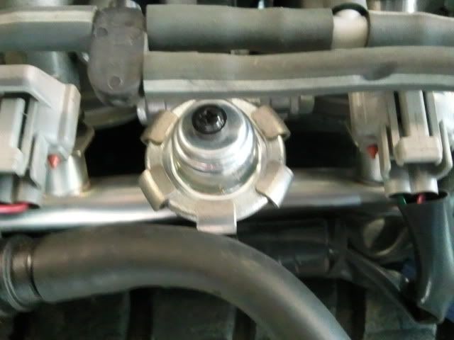

posted on 21/10/10 at 11:41 AM Reply With Quote
cheers, also just checked the fuel rail has a pressure regulator, is this it?
also this black box? am i right that it has the input from the fuel pump on the one side, then the one input on the other to the fuel rail, then the other back to the fuel tank?
