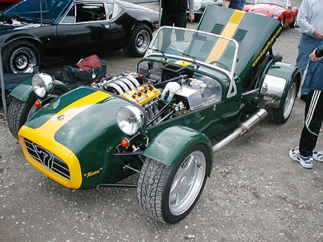

If I'm not mistaken, any and all of complete LHD BEC Caterhams are assembled by a shop here in B.C. Canada. His company goes under the name of
"Super Seven Cars" to get around some of our tough import regulations so that they can be sold and run here (but for all
intents-and-purposes, they're still Caterhams).
Check out their website for more details of the chain drive (which by the way is a beautifully executed system. I'm thinking more and more of
going this route with my Locost), but here are a series of pictures:
http://www.super7cars.com/

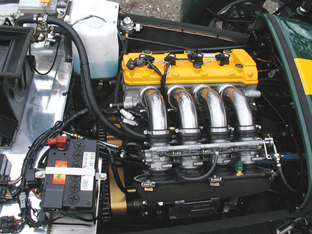

| posted on 19/6/04 at 03:56 AM |
Engine-bay view:

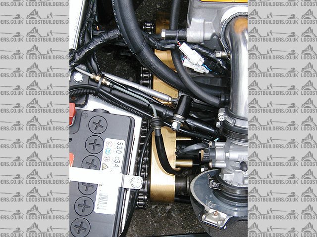

| posted on 19/6/04 at 03:58 AM |
Chain drive detail:

PeterGT4
| posted on 22/6/04 at 08:09 PM |
quote: Originally posted by Mave
... Their installation is very neat. You might be able to install an electric reverse in that chaindrive too, somewhere...
He uses a separate reverse gearbox, inline with the driveshaft. I'm not sure if its the one from Quaife...
