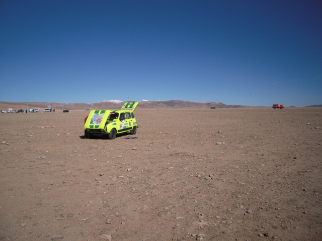

The car is a Renault 4 i have used to go to Marocco to eat some sand, with 2000 other french students like me... But 40hp is very very insufficient to have fun, so i bought a gsxr engine, with a 1216cc kit (12:1 compression ratio) that i'm gonna put in the car.
I've chosen this engine because i ride a GSXR 1100 as a daily and i know a lot of this engine. Besides, as you probably know, it is fookin cheap, parts also, and very reliable, and that's the most important for me, since i'm gonna go back in the desert with it.
I've gathered all the bits. Now i need to finish school year in a month, to begin the build.
Since the vacuum carbs (OEM) don't like G-force, i also gathered everything to go EFI : GSXR 600 K1 throttle bodies, microsquirt, EFI pump from a 1000 GSXR K6, Innovate LC-1 wideband lambda sensor...
Here is what the car looks like :
And an another, during the trip :
Can't wait to get my hands in it !!

Don't see many R4's these days.
Agreed the engines are nice and simple, I have got through a few, but mostly because I have bought cheap and generally put fairly broken engines in which didn't heal themselves!
I see large oil coolers in your future!
Is this going in the front?
One problem that would concern me if I were going into a dessert would be electrical power. One problem with these old engines is that the alternators are crap (and get worse as they get hot), not helped by adding EFI with all the power draw from pumps and injectors and lambda probe. I guess solar panels on the roof and a big battery might be a good idea as you could recharge everything while the engine cools down.
