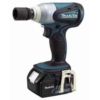

| posted on 7/9/11 at 09:41 PM |
I use a battery powered impact wrench like this:
Dead easy

| posted on 8/9/11 at 08:53 AM |
impact wrench, although when doing it back up you have to guess the torque
Lightning
| posted on 8/9/11 at 07:42 PM |
Got it off with an impact wrench. thanks.
