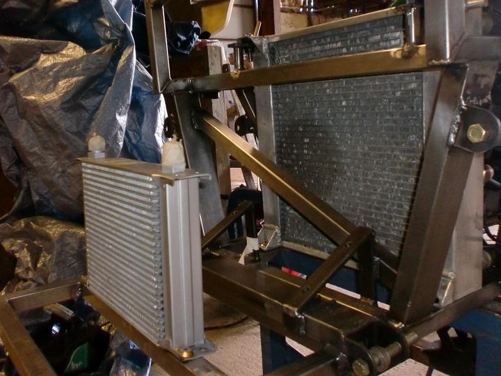

Any good ideas on what to do about top-mount for oil cooler?
The top of my oil cooler currently resides in free-space, miles from any sort of chassis tube.
I can't decide what to do about it short of giving it its own special framework - PITA and heavy.
Any better thoughts?
TC

The thought had crossed my mind but I deceide that its too experimental at this stage. Its staying where pictured but I need to tie-in the top.

Two ally flat straps bent , drilled and bolted to either end of the mountings on the cooler, then drilled and bolted onto two weld on tabs/captive nuts on the top rail. Does the cooler not need to sit on rubber ?

Mine is like this - the top is held in place only by the two oil lines (though I have four rubber cotton reel mounts underneath). TBH it seems pretty secure, I'm not really worried about it going anywhere.

move it back, in front of the radiator, aluminium angle bolted to the radiator mountings, oil cooler bolts to aluminium angle
perhaps the top wishbone brackets somehow form the basis for the top bracket? aluminium anlge bolted across it, for example?
