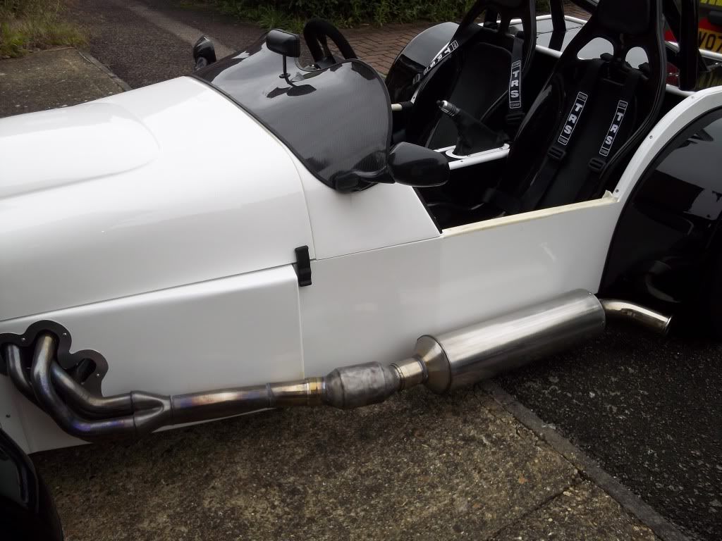

I've just got back from my local friendly mot station where i got them to check the headlights, brakes and emission before i book the IVA. Turns out the emissions are way too high. Co was 7.0% where it should be 0.2%, HC was 450 ppm where it should be 200 ppm, lambda was 0.80 i believe rather than 1.00. I have a healtech FI fitted (power comander type fuel controller) so i leaned it off as much as i could but i could only get it down to 5% CO. I've seen some of you have had to reduce the fuel pressure to get it lean enough but what regulator should i get? I also had it mapped the other day so there is nothing wrong with the way the engine is running.

Davegtst
posted on 2/7/12 at 04:37 PM Reply With Quote
No the cat is just before the silencer. I had it running at about 3000 rpm for about 5 mins, not sure if this was enough though.

Davegtst
posted on 2/7/12 at 04:48 PM Reply With Quote
Hmmm can't get it any closer, the pipe is only about 10mm away from the side panel as it is.

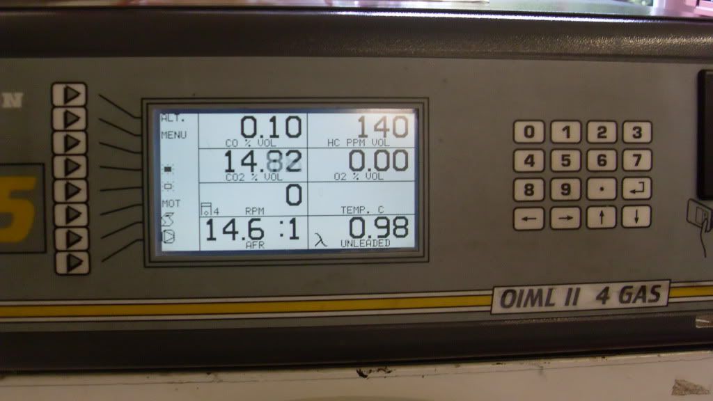

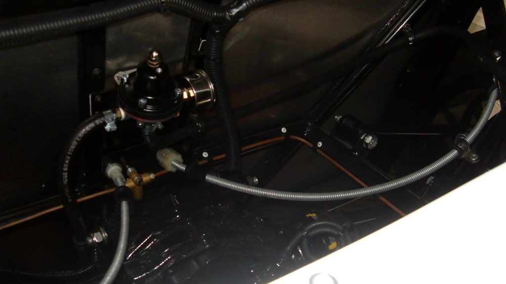

Davegtst
posted on 10/7/12 at 10:40 AM Reply With Quote
Result!! I have turned the fuel pressure down via an FSE regulator in the back from 43 psi as it is standard to 23 psi. This is with the PAIR system removed, without the manifold wrapped and the cat fitted. What i don't quite get is it was mapped without the cat at 43 psi but to get it to through the emissions test i need to lean it right off. Surely it can't be safe to run it at 23 psi for long periods. As soon as it's passed i intend to put the fuel pressure back to where it was mapped at.
