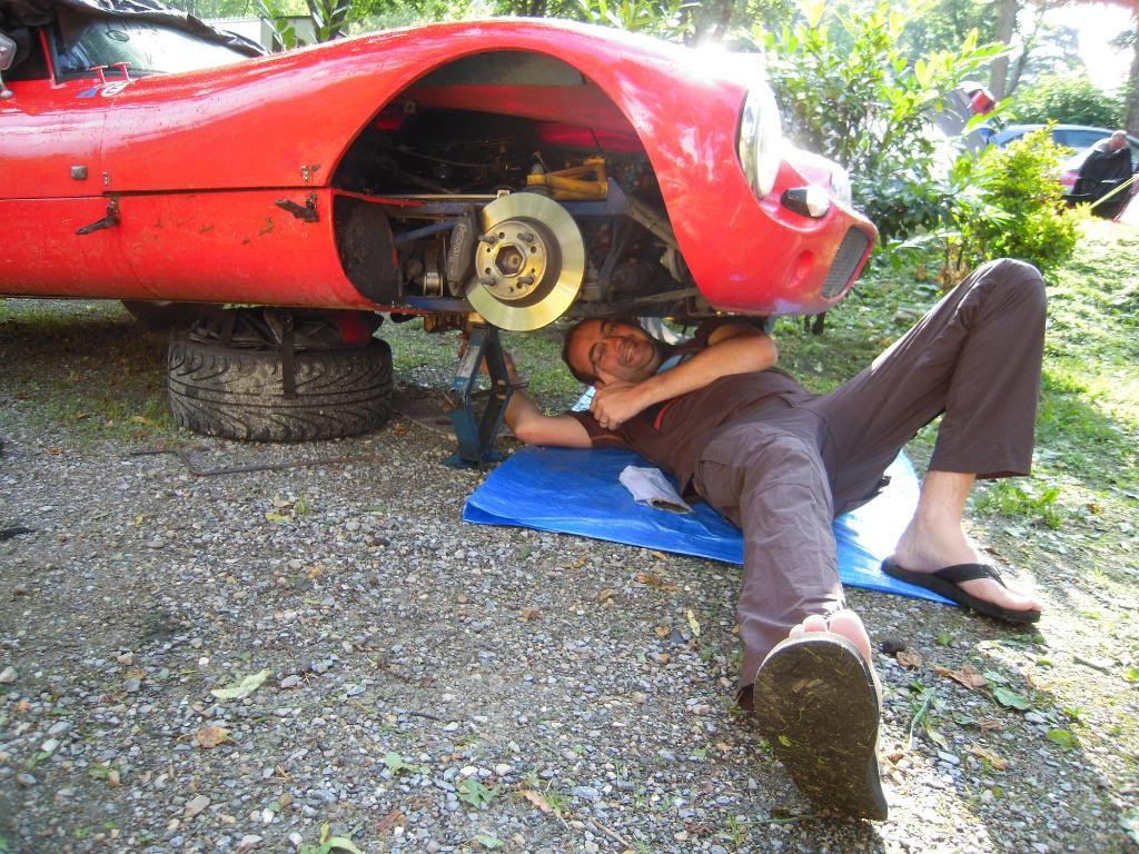

At the same time I did this:
I also did this:
however whilst replacing the sump in a French campsite with the car precariously balanced on a scissor jack I didn't spot it and blamed the resulting oil leak below the sight case on the sump gasket being re-used too many times.
