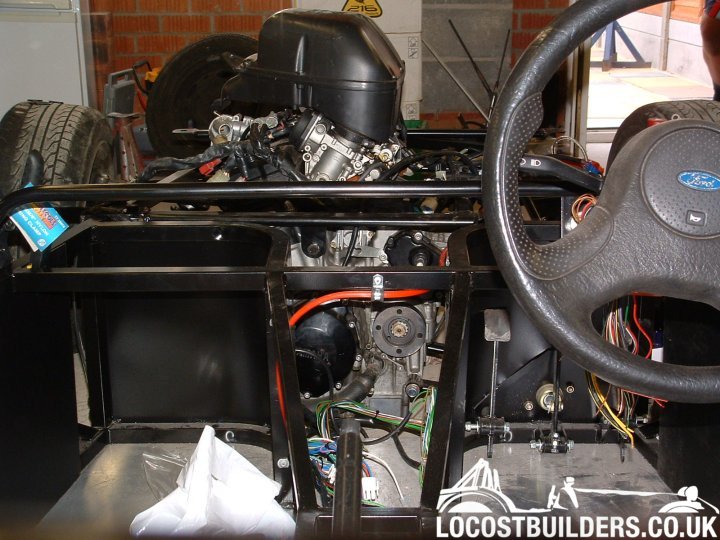

Hi im kinda new to all this but i need some help im having problems finding out a way of fitting a hayabusa engine and getting the drive from the engine to back axel also most bike engines are chain drive to rear wheel so how do get the drive to prop. if anyone has done this and has pics or anything that would be great

all you need is a prop adptor from some one like MK, take off the sprocket fit the prop, not the best pic but heres one i did earlier...........

Engine and gearbox all together in the bike. The sprocket adaptor which replaces the sprocket is on the output of the gearbox so just connect prop to this and the other end to the diff.
My pic is of a 2003 R1 with adaptor fitted but without the prop.
http://www.locostbuilders.co.uk/upload/311.jpg
