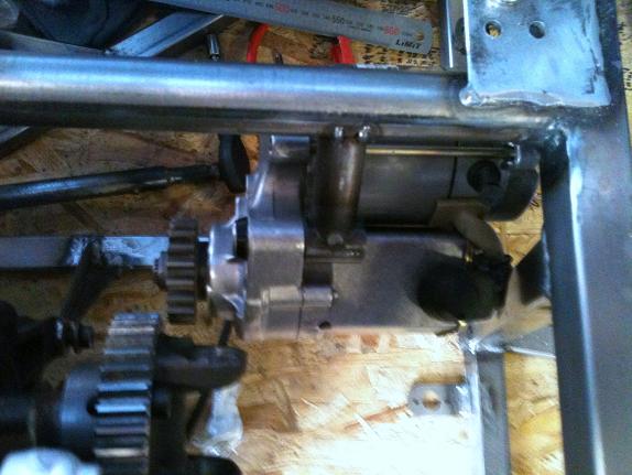

IainL
| posted on 13/5/13 at 06:24 PM |
Here's a photo of my reverse set-up fitted to the engine end with a gear sandwiched between the engine output flange and the prop.
Brought this from Aries Motorsport a couple of years ago.
  Aries Electric Reverse
If you want anymore pics just let me know
Iainl

IainL
| posted on 13/5/13 at 07:40 PM |
Mine currently has a gear lever shift set-up, the reverse is also operated by a lever which you pull to engage the gears and then push the button on
top of the lever to rotate the starter and therefore move the car.
a few more photos below and in my archive
  rev-3
  rev-5
  rev-7
If you want any specific photos or need anymore info please advise me accordingly
Iainl
