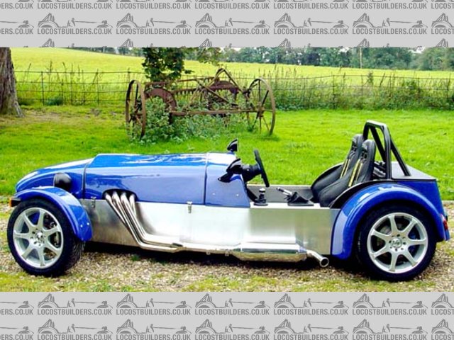

hi got my velocity on the road on saturday. I'm also using a zetec but it's a 1.6 running webers but it's too fast anyway!
![](/galpreviews/a155740-car 1.jpg) ![Rescued attachment car 1.jpg](/gallery/a155740-car 1.jpg) Rescued attachment car 1.jpg
